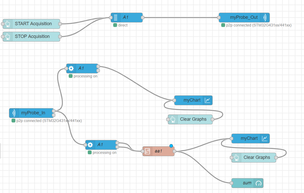

I've been having issues filtering out values from my processing module
1) for the second graph and gauge i went in and modified it to look like this
i wanted to extract a variable out of my list called sum so in the varfilter i placed sum as a string input but when i go to deploy, nothing comes out of it.
any ideas ?
attached the whole thing in a zip

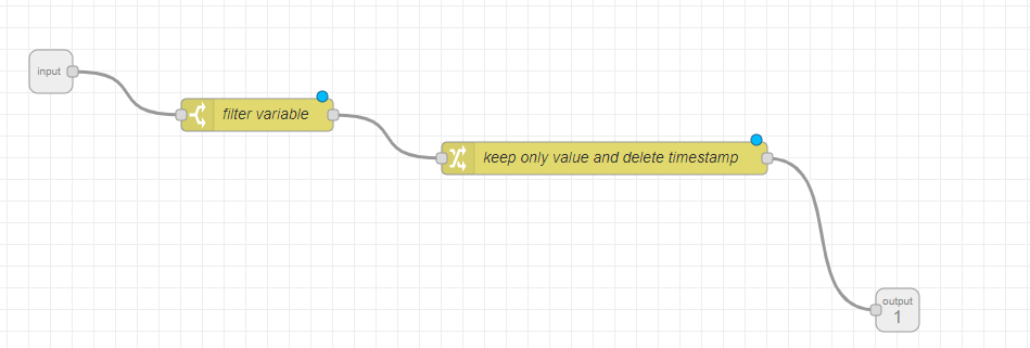

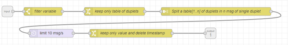

The subflow "single value" in your flow is not the one provided with the tool and that's why is not working :
Good one ;
The one in your flow :
If you modified this subflow by mistake , you can retrieve it in the library (Menu in the right of the tool next to dashboard button)
( Import -> Library -> STM32CubeMonitor_BasicFlow.json )
