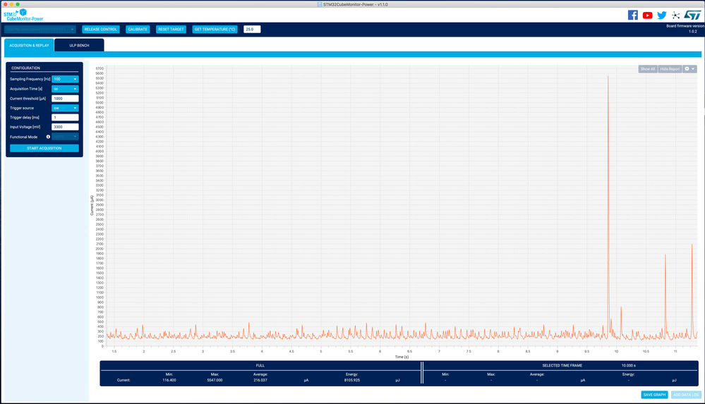

if i record the power everything looks good like:

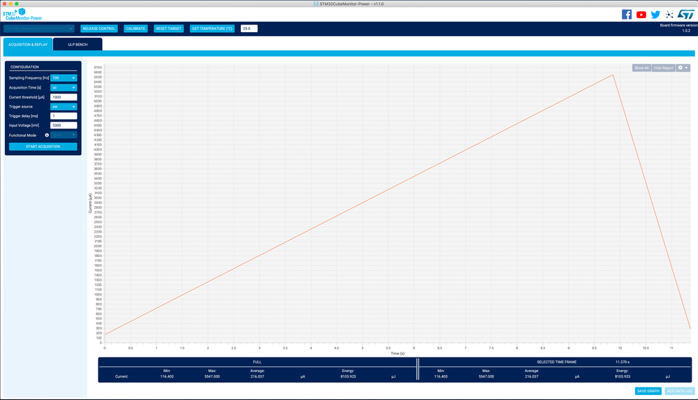

but, if i zoom in/out or press "Show All" it looks like this:

Data are subsampled to be displayed in the chart ( reducing the amount of points to avoid crashing the graph ). In your case it seems that the subsampling ratio is very high ( keeping only min and max values ).

Hi Aritec,
A Data Log is composed of at least 3 files :
  • an xml with metadata ( config of the acquisition, min , max... )
  • a summary file to load quickly the complete acquistion already subsampled
  • all the raw data files ( from one to X depending on the length of acquisition and frequency ).
There is an issue with your data log as the rawlog file is not available in it : 2020_03_02_07_07_27_1_rawfile_1.csv .
I don't know yet why , but can you check on your side that when you perform an acquisition something is stored under :
"YourUserDirectory"\AppData\Local\Temp\Power_Monitor\Acquisition\
You should find here one directory for each acquisition with inside at least the 3 files mentioned.
Thank you
Landry
Aritec,
The path mentioned was for windows , for mac, acquisitions are stored under :
"YourUserDirectory"\Library\Power_Monitor\Acquisition\
Landry
Aritec,
I reproduced the issue on our side. Let me come back to you asap
I confirm the issue and solution found. I will deploy a new release (1.1.1 ) asap
