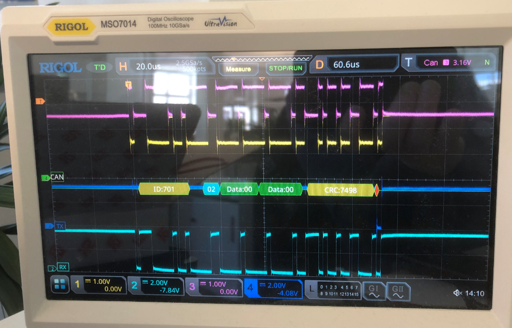

P.S. TX works perfectly fine, as you can see it Ack's the 0x701 Frame that was received.

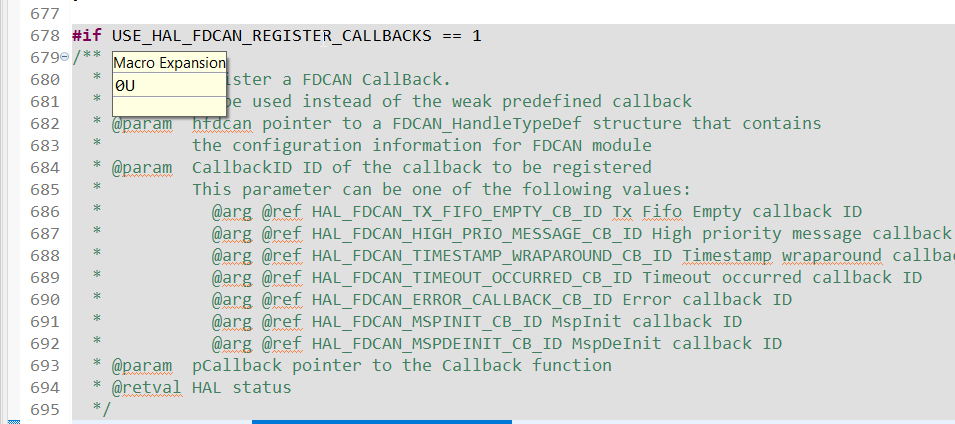

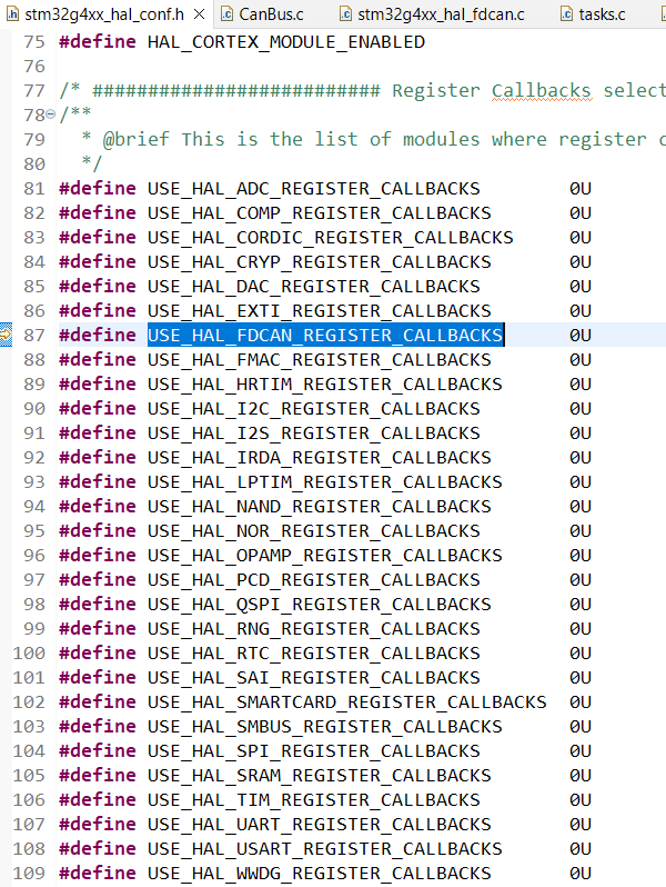

2023-04-04 7:50 AM
If I remember correctly, this is only if you want to use callback(s) other than the default one already provided. You can leave this to 0, it will not prevent the callback function to be called when an RX IT is triggered.

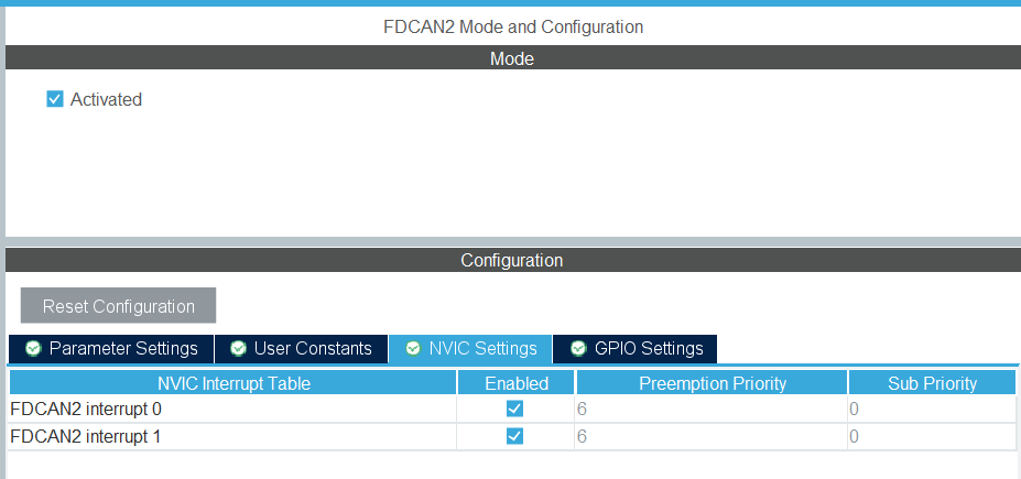

2023-04-04 7:52 AM
The screenshot I took is for an F series MPU, but as far as FDCAN is concerned, this should be very similar to the Gs.

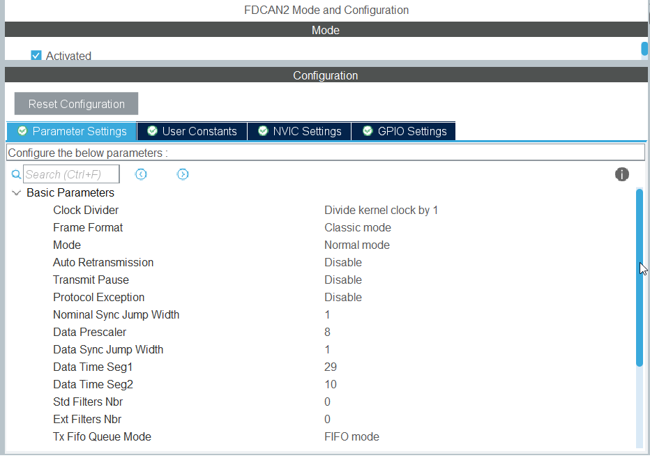

Can you copy-paste the FDCAN_InitTypeDef structure declaration that was generated?
