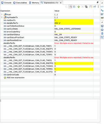

I'm trying can bus interface on dev board nucleo-f103RB. I immediately pass the self-loop test mode and move on to build a minimal CAN with 2 nodes(2 f103RB, one as transmitter and the other as listener). I'm using normal communication mode for this test and two simple tja1050 breakouts as transceivers. On the breadboard, I use two 120 ohm resistor on each end of the bus to close it, and I power the whole on one of the nucleo-f103RB. The connection between controller and transceiver is Tx to Tx, Rx to Rx.
The problem I encountered is that, I always get RQCP0 and TERR0 reported 1 after sending the tranmission request. I tried to look deeper at the error reported, calling function HAL_CAN_GetError to take a look at the error status register (CAN_ESR) but it would always be cleared and left with 0x1000 with 0b000 on the Last Error Code part. This makes me really confused.
To summarize my questions:
1. what are the pre-requisite for the normal mode to functioning? Does it require external hardware connections? or as long as the code is doing the right thing, the sending would be successful?
2. how to make sure we activate the callback functions in CAN, I've set the callback by calling the function HAL_CAN_ActivateNotification and change the NVIC settings accordingly, but only HAL_CAN_RxFifo0MsgPendingCallback could work as expected and all others like
HAL_CAN_TxMailbox0CompleteCallback() and HAL_CAN_ErrorCallback() are not triggered even I've activated the notification.
I paste most important code snippets for reference here and the hardware connection is in attachment, thanks for your help!

2023-07-31 3:46 PM
@CWang.14 wrote:Hello staff,
(I wouldn't use Staff this way in a forum, forum staff are not my employees :grinning_face_with_sweat:)
2023-07-31 3:55 PM
Ok for sure I'll use friends lol, if that's more suitable
