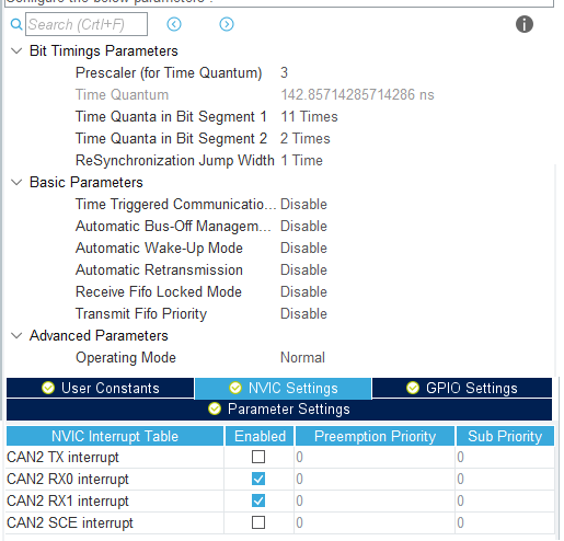

I'm using a CAN bus on my STM32F446RE. Right, now, the CAN communication is working with only one rx filter. I saw in datasheet that we can use up to 128 filters. I don't need so many filters, but I'm trying to configure a second filter. Unfortunately, when I do this, the MCU does not receive any message (although it compiles without error).
So my question is : how can I config two CAN filters with HAL library ?
Here is my code ( sFilterConfig2 is commented because it is the part that breaks my application) :

Additionnal infos :
