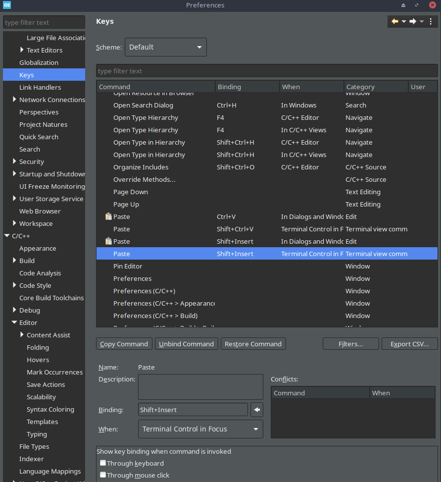

+ maybe you could stop the paste action in IDE adjustments -> editor ->
2023-03-13 11:59 AM
Not just linux, it does this in windows as well. The Preferences you show are for keybindings not mouse behavior. Unfortunately, there is control I can see in the mouse control panel to turn off the middle mouse button and there is no control in Input Re-mapper to tell it to do nothing or something benign.
