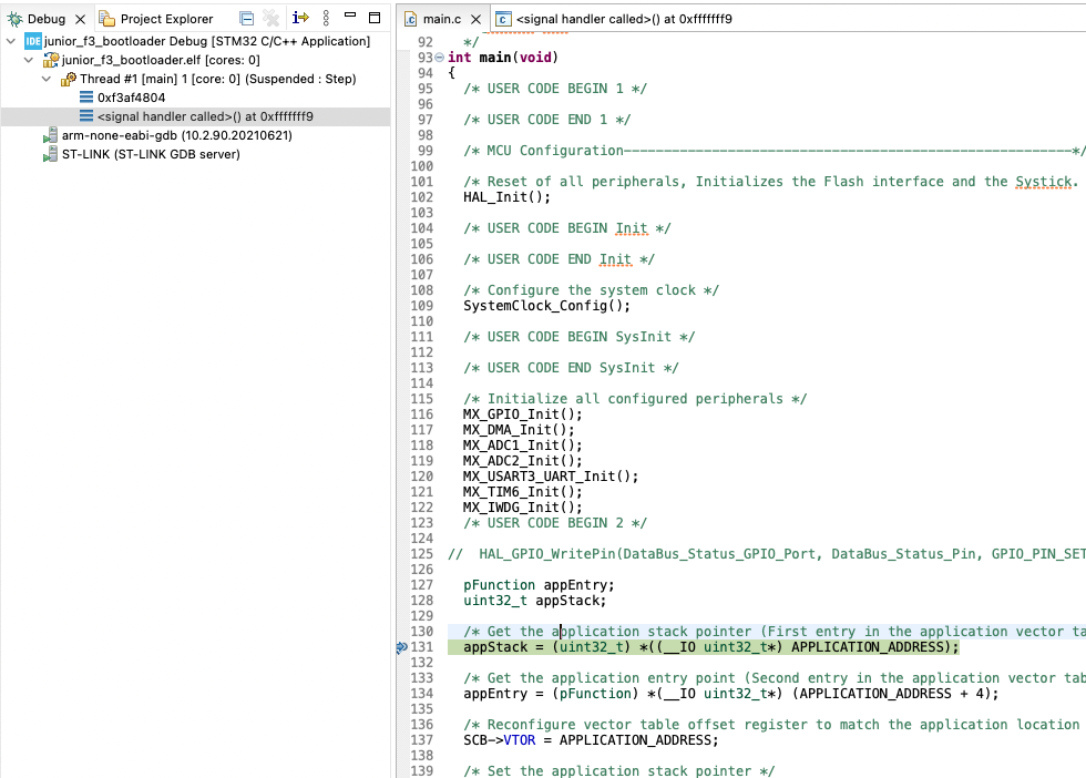

}When I run this, it crashes on line 14 when I assign appEntry:
If I comment all this code and let it go into the while loop, it functions normally.
So I know it has to do something with the memory addresses - but I am unsure how to continue from here.
How do I make this project working again in CubeIDE, and preferably without re-flashing all existing boards with a new bootloader (if this is possible: a bootloader built with SW6 that starts the application built with CubeIDE)

Watch what address it is actually using. Look at generated code.
Watch for changing the stack frame and how that will impact auto/local variables in the current scope.
Suggest letting the Reset_Handler in the app code set its own initial SP value, negating the need to do it here.
Have a HardFault_Handler that does something useful.
2023-03-14 10:16 AM
It's the time to get acquainted with the hardfault analyzer of CubeIDE. (does SW3STM32 have this tool too?)
When you change VTOR in line 20, the next systick interrupt will arrive there.
