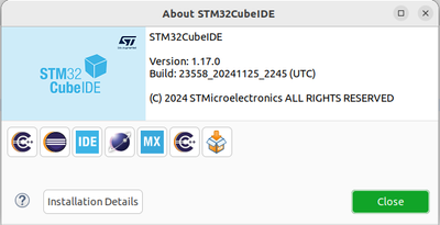

Are you using the latest version of STM32CubeIDE 1.17.0?
KR, Souhaib
2025-02-13 6:49 AM
Hi @Souhaib MAZHOUD ,
Yes.

Hi @DShekter
Let's try to reinstall a fresh version of Stm32CubeIDE 1.17.0 and check if the issue persists.
2025-02-13 8:09 AM
Turns out I had installed 1.10 from a deb. I purged that and reinstalled from the website. So far so good, but it's probably too soon to tell. If I don't see it for a while I'll mark that as the answer.
Thank you
2025-02-14 9:40 AM
The good news is that it took almost 24 hours for it to show up again, the bad news is that it just did after unlocking my computer. Looks like a clean install helped but didn't fix it.
Thank you
