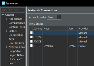

Hello @MSchm.1,
I suggest that you try to set the active provider to direct in network connection.
Then you check the connection in firmware Updater.
And you will be able to connect to your account.

And as said, I also tried DIRECT and NATIVE connections. It does not help!

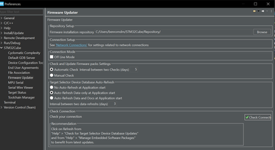

The same problem.
STM32CubeIDE 1.14.1 on Windows10.
Pressed "login" to myST. Nothing happened.
Pressed "Manage Embedded Software Packages". Nothing happened.
Local account with administrative privilegs.
Antivirus and firewall turned off.
No proxy (tried native and direct modes).
Check for Updates - Ok
Check for Target Selector Device Database Updates - Ok
Firmware Updater / Check Connection - Ok
