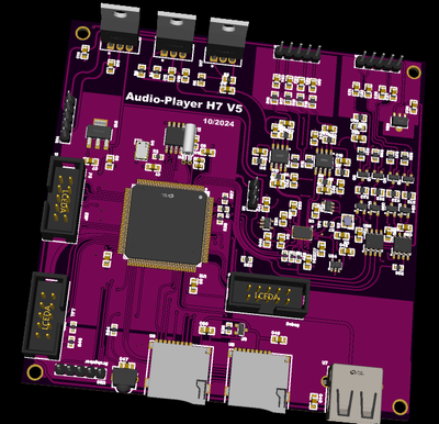

- custom board with H743ZI , 2x sd-card , 1x USB msc , for USB stick data;

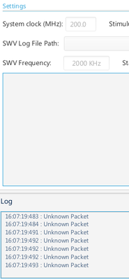

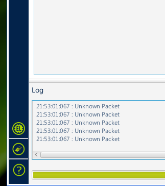

Then i checked with CubeProgrammer (has SWV also) and it shows : something is sent, but hangs him up,
last thing CubeProg showing is this : <unknown packet> (then need to kill the prog, not any reaction)

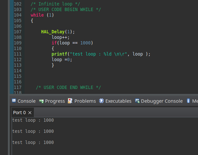

made a new project,dummiii, same hardware, at 200M, but only : debug + swv , nothing else.
and this .... can send swv, no problem !

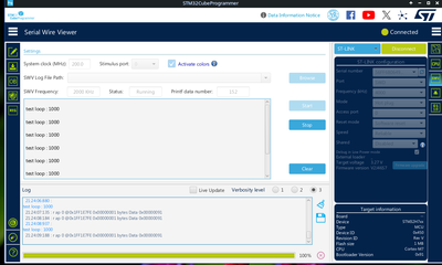

So checking, what was flashed, with CubeProgrammer, it shows:
Fine, dummiii flashed, and swo working. But IDE cannot debug any more , what it just flashed ??

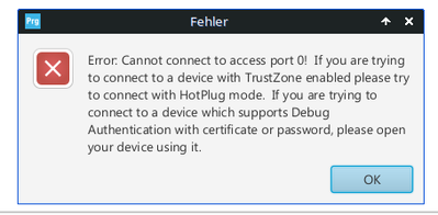

hmmm - so check with connect on CubeProgrammer : hey, it has new info for me !!!! see:
btw I never played around with trustZone or chip protection levels.

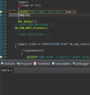

obviously dummy flashed, but still no correct swo:
So set debug to OCD, debug hangs in startup and exit. After third attempt, suddenly strt debug:
--- but still no swo , correct swo.

The hardware i didnt show, because : its working fine and has nothing special, just cpu , 3v3 linear supply, sd and usb ; and DACs and analog circuits have nothing to do with these problems; on my test board anyway not fitted, only the digital part + TFT connection.

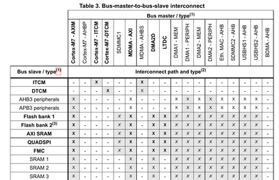

But other problem i found : (my error) can the DMA reach the memory at all?
So looking at H7 bus matrix :
This might explain, why dma on sdmmc2 working, but not on sdmmc1, depending on the RAM, its using. (or i gave it...) So this is more or less clear now.

The not working program SWO sending something , "unknown packet", but i have no idea, why this is always "wrong", with same settings in clock tree , same hardware, all optimizer settings tried - no change.
