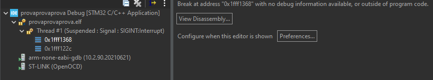

Now I was trying to debug with another board I have, still with the same MCU, and something went on and I don't know what.
Debugging has started, but always hangs at this point:
The messages I see in the console are these:

Warn : GDB connection 1 on target STM32G050F6Px.cpu not halted
undefined debug reason 8 - target needs reset
Info : accepting 'gdb' connection on tcp/3333
Warn : GDB connection 2 on target STM32G050F6Px.cpu not halted
target halted due to debug-request, current mode: Thread
xPSR: 0xf1000000 pc: 0x1fff1654 msp: 0x20000e48

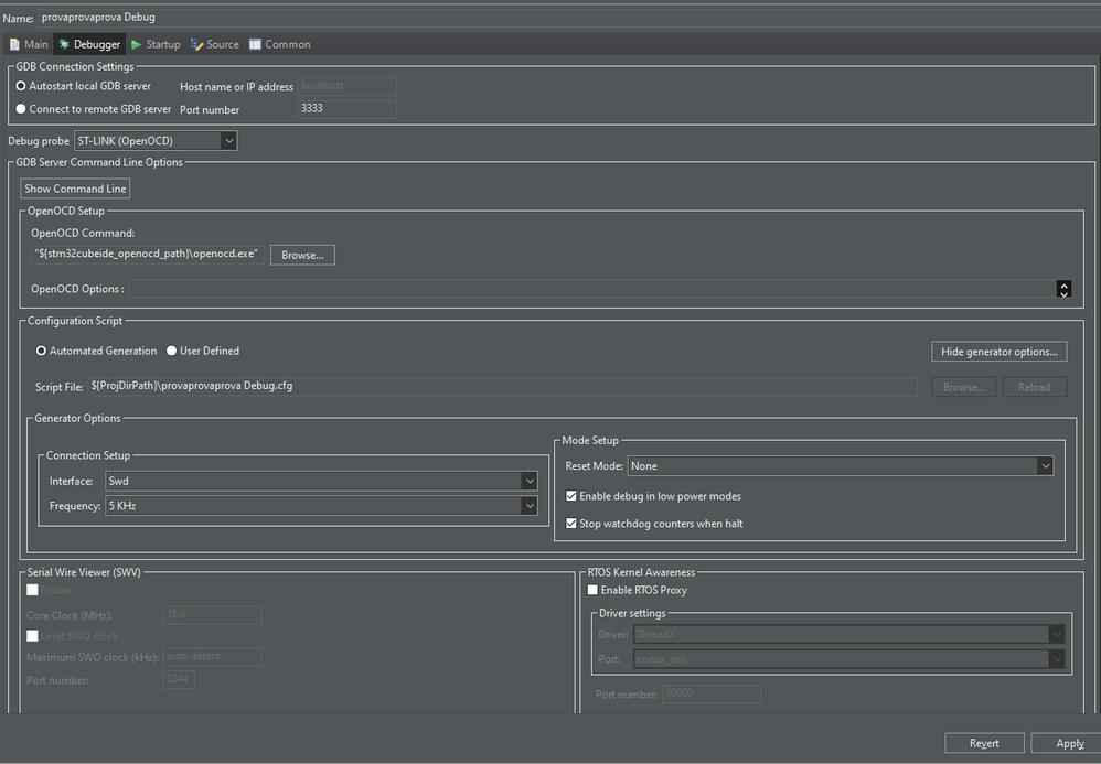

good ! so (on this board) all ok, cpu working and connection ok. -> can work with ST...programmer.
Ide: something you still wrong/bad adjusted.
try: in debug settings: SWD , 4MHz (or lower) ; resetmode: software system reset , + enablew low power ,+ stop watchdog.

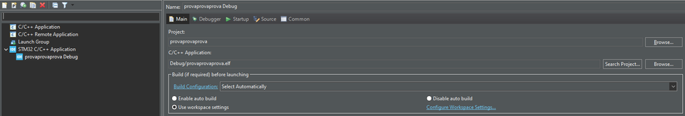

@AScha.3​  and @Community member​ nothing changes!! I've been here for now 2-3 weeks and nothing is working.
The scheduling and degubbing configurations are:
Run configuration
Debug configuration:
If someone could figure out what's wrong with the messages I get on the console it would be a huge favor:
