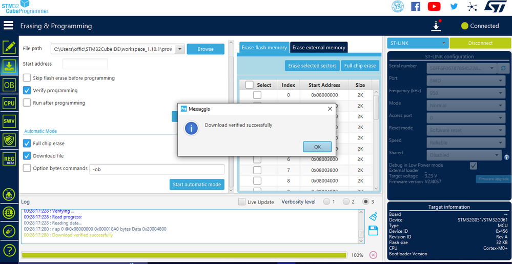

I have a small problem: I bought some STM32G0P0.. for my project, also making the PCB and the rest. But after soldering the various components, I try to program one and see that the level 2 protection is active, I try to program another and there is the same thing.
What I see from the STM32 St-LINK program is that only some memory pages have protection, while others don't, but then going to view the memory areas I see that they have all been set to FFFFFFFF.
Below I can see that the memory on the address 0x08001400 is free, but..
..here I see that is protected! How can I program it?
My question now is: what the hell do I do? Do I ask for a return? Is this a normal thing of STM32G0...? Trying to write a bootloader that makes me jump from one address to another when the memory to read is full?

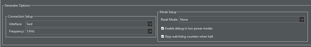

0693W00000WKO9jQAH.pngset:
  • automated
  • 4 MHz
  • software system reset
  • keep pin boot0 lo , at gnd.

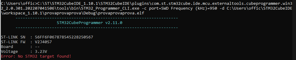

Test1: Try to flash your application relying on CubeProg CLI by using this command:
C:\ST\STM32CubeIDE_1.10.1\STM32CubeIDE\plugins\com.st.stm32cube.ide.mcu.externaltools.cubeprogrammer.win32_2.0.301.202207041506\tools\bin\STM32_Programmer_CLI.exe -c port=SWD -d C:\Users\norlandm\STM32CubeIDE\workspace_IPCEI\STM32F4_RTOS\Debug\STM32F4_RTOS.elf
Obviously you need to modify the two paths in the above example. Does Test1 work well or not?
If not, then we know that the root-cause is isolated to CubeProg CLI ( or potentially the flash loader).
I think this test will be successful. But we have to execute it anyway to narrow down the scope!

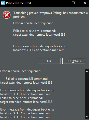

This leads us to Test2:
  1. Use CubeProg stand-alone GUI version to flash your application
  2. Disconnect CubeProg. De-tach and re-attach the board to your PC
  3. In CubeIDE setup a debug configuration which does NOT load the elf-file to target. Use default settings in the debug configuration (use ST-LINK GDB server) and then make these specific settings:
    1. Reset strategy : Connect under reset
    2. Enable low power debug modes (just to be safe)
    3. In the Startup tab > Load Image and Symbols > Debug/myproject.elf > Edit
      1. Disable the Download check-box
With this configuration STM32_Programmer_CLI.exe will not be involved at all. No flashing will be done from the IDE. It assume that the flashing is manually done in step1. All IDE is doing is to reset and connect to the device to just take control of the debug session.
Let us know - what works - what does not work?!

No no, this is not my configuration, I don't know how I managed to take this screenshot.
However my configuration is the same except for the Speed, which I set at 950khz, since with STM32Programmer I can connect to the device with that frequency and not with 4MHz.
If I try to set the speed to 4MHz I get this error:

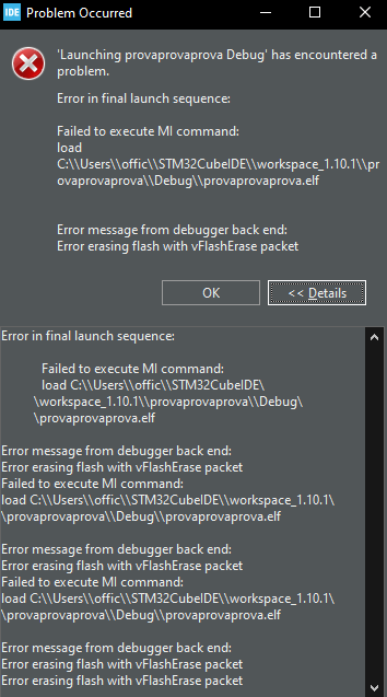

Instead when I try to program it I get the same error as before, but with this message:
Open On-Chip Debugger 0.11.0+dev-00449-g53fa0f7 (2022-06-09-09:42) [https://github.com/STMicroelectronics/OpenOCD]
Licensed under GNU GPL v2
For bug reports, read
	http://openocd.org/doc/doxygen/bugs.html
Info : Listening on port 6666 for tcl connections
Info : Listening on port 4444 for telnet connections
Info : STLINK V2J40S7 (API v2) VID:PID 0483:3748
Info : Target voltage: 3.254557
Error: init mode failed (unable to connect to the target)

I tried to do test 1, setting only the port in the first time, then, after seeing that it didn't detect an STM32 device, I also tried to set the frequency, but nothing:
For test 2, following all your directions, it still doesn't go debugging.
The error messages are these:

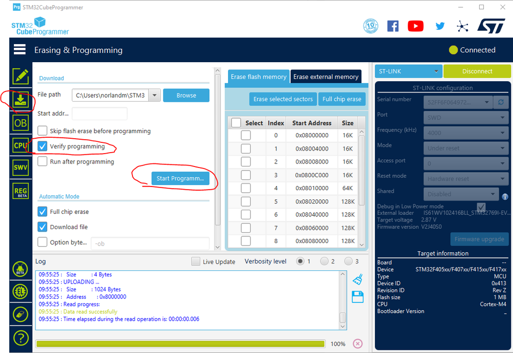

Hi Franz,
Hmm... Let me tie back to Test2! Are you saying that CubeProg GUI version could connect to the device and flash the binary successfully??
0693W00000WKdSRQA1.pngPlease confirm. Even please put the CubeProg log information with verbosity level 3?!
It would be very weird if CubeProg GUI work and CubeProg CLI does not work... We need to clarify this first.
You could also drop me a PM if we should setup a remote session.

  00:29:26:458 : w ap 0 reg 9 R9   0x00000000
  00:29:26:460 : w ap 0 reg 10 R10  0x00000000
  00:29:26:460 : w ap 0 reg 11 R11  0x00000000
  00:29:26:465 : w ap 0 reg 12 R12  0x00000000
  00:29:26:466 : w ap 0 reg 13 SP   0x00000000
  00:29:26:467 : w ap 0 reg 14 LR   0x20000001
  00:29:26:469 : w ap 0 reg 15 PC   0x20000387
  00:29:26:470 : w ap 0 reg 16 xPSR 0x01000000
  00:29:26:471 : w ap 0 reg 17 MSP  0x20000B54
  00:29:26:472 : w ap 0 reg 18 PSP  0x00000000
  00:29:26:472 : run ap 0
  00:29:26:545 : halt ap 0
  00:29:26:547 : r ap 0 reg 0 R0   0x00000001
  00:29:26:548 : erase: 0198ms
  00:29:26:548 : Download in Progress:
  00:29:26:549 :   Size          : 6304 Bytes
  00:29:26:549 :   Address       : 0x08000000
  00:29:26:549 : Buffer program...
  00:29:26:560 : halt ap 0
  00:29:26:560 : w ap 0 reg 15 PC   (0x20000000)
  00:29:26:560 : w ap 0 reg 17 MSP  (0x20000500)
  00:29:26:560 : w ap 0 reg 16 xPSR (0x01000000)
  00:29:26:566 : w ap 0 @0x20000B80 0x00000200 bytes Data 0x00000000
  00:29:26:571 : w ap 0 @0x20000000 0x00000004 bytes Data 0x0000BE00
  00:29:26:594 : w ap 0 @0x20000004 0x00000754 bytes Data 0x483EB580
  00:29:26:595 : Loader write range...
  00:29:26:646 : w ap 0 @0x20000B80 0x00000C50 bytes Data 0x20004800
  00:29:26:646 : W B1 in RAM @0x20000B80 size 0x00000C50 : 0052ms
  00:29:26:646 : Init flashloader...
  00:29:26:650 : halt ap 0
  00:29:26:651 : w ap 0 reg 0 R0   0x00000001
  00:29:26:652 : w ap 0 reg 1 R1   0x00000000
  00:29:26:653 : w ap 0 reg 2 R2   0x00000000
  00:29:26:654 : w ap 0 reg 3 R3   0x00000000
  00:29:26:655 : w ap 0 reg 4 R4   0x00000000
  00:29:26:656 : w ap 0 reg 5 R5   0x00000000
  00:29:26:658 : w ap 0 reg 6 R6   0x00000000
  00:29:26:659 : w ap 0 reg 7 R7   0x00000000
  00:29:26:661 : w ap 0 reg 8 R8   0x00000000
  00:29:26:662 : w ap 0 reg 9 R9   0x00000000
  00:29:26:663 : w ap 0 reg 10 R10  0x00000000
  00:29:26:669 : w ap 0 reg 11 R11  0x00000000
  00:29:26:672 : w ap 0 reg 12 R12  0x00000000
  00:29:26:675 : w ap 0 reg 13 SP   0x00000000
  00:29:26:676 : w ap 0 reg 14 LR   0x20000001
  00:29:26:677 : w ap 0 reg 15 PC   0x20000005
  00:29:26:677 : w ap 0 reg 16 xPSR 0x01000000
  00:29:26:677 : w ap 0 reg 17 MSP  0x20000B54
  00:29:26:678 : w ap 0 reg 18 PSP  0x00000000
  00:29:26:678 : run ap 0
  00:29:26:678 : halt ap 0
  00:29:26:680 : r ap 0 reg 0 R0   0x00000001
  00:29:26:687 : w ap 0 reg 0 R0   0x08000000
  00:29:26:687 : w ap 0 reg 1 R1   0x00000C50
  00:29:26:689 : w ap 0 reg 2 R2   0x20000B80
  00:29:26:691 : w ap 0 reg 3 R3   0x00000002
  00:29:26:694 : w ap 0 reg 4 R4   0x00000000
  00:29:26:696 : w ap 0 reg 5 R5   0x00000000
  00:29:26:697 : w ap 0 reg 6 R6   0x00000000
  00:29:26:698 : w ap 0 reg 7 R7   0x00000000
  00:29:26:698 : w ap 0 reg 8 R8   0x00000000
  00:29:26:699 : w ap 0 reg 9 R9   0x00000000
  00:29:26:699 : w ap 0 reg 10 R10  0x00000000
  00:29:26:700 : w ap 0 reg 11 R11  0x00000000
  00:29:26:701 : w ap 0 reg 12 R12  0x00000000
  00:29:26:703 : w ap 0 reg 13 SP   0x00000000
  00:29:26:710 : w ap 0 reg 14 LR   0x20000001
  00:29:26:710 : w ap 0 reg 15 PC   0x2000003B
  00:29:26:712 : w ap 0 reg 16 xPSR 0x01000000
  00:29:26:713 : w ap 0 reg 17 MSP  0x20000B54
  00:29:26:714 : w ap 0 reg 18 PSP  0x00000000
  00:29:26:714 : run ap 0
  00:29:26:750 : w ap 0 @0x200017D0 0x00000C50 bytes Data 0x2201681B
  00:29:26:750 : W B2 in RAM @0x20002480 size 0x00000C50: 0101ms
  00:29:26:751 : r ap 0 reg 0 R0   0x00000001
  00:29:26:751 : Wait W B1 in Flash @0x08000000 size 0x00000C50: 0002ms
  00:29:26:754 : w ap 0 reg 0 R0   0x08000C50
  00:29:26:757 : w ap 0 reg 1 R1   0x00000C50
  00:29:26:761 : w ap 0 reg 2 R2   0x200017D0
  00:29:26:763 : w ap 0 reg 3 R3   0x00000002
  00:29:26:764 : w ap 0 reg 4 R4   0x00000000
  00:29:26:764 : w ap 0 reg 5 R5   0x00000000
  00:29:26:766 : w ap 0 reg 6 R6   0x00000000
  00:29:26:766 : w ap 0 reg 7 R7   0x00000000
  00:29:26:766 : w ap 0 reg 8 R8   0x00000000
  00:29:26:766 : w ap 0 reg 9 R9   0x00000000
  00:29:26:768 : w ap 0 reg 10 R10  0x00000000
  00:29:26:769 : w ap 0 reg 11 R11  0x00000000
  00:29:26:770 : w ap 0 reg 12 R12  0x00000000
  00:29:26:771 : w ap 0 reg 13 SP   0x00000000
  00:29:26:780 : w ap 0 reg 14 LR   0x20000001
  00:29:26:782 : w ap 0 reg 15 PC   0x2000003B
  00:29:26:784 : w ap 0 reg 16 xPSR 0x01000000
  00:29:26:786 : w ap 0 reg 17 MSP  0x20000B54
  00:29:26:787 : w ap 0 reg 18 PSP  0x00000000
  00:29:26:787 : run ap 0
  00:29:26:817 : r ap 0 reg 0 R0   0x00000001
  00:29:26:817 : Write elapsed time: 0217ms
  00:29:26:817 : Segment[0] downloaded successfully
  00:29:26:817 : File download complete
  00:29:26:839 : Time elapsed during download operation: 00:00:00.463
  00:29:26:841 : Verifying ...
  00:29:26:841 : Read progress:
  00:29:26:841 : Reading data...
  00:29:26:906 : r ap 0 @0x08000000 0x000018A0 bytes Data 0x20004800
  00:29:26:906 : Download verified successfully
