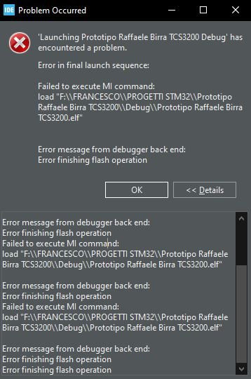

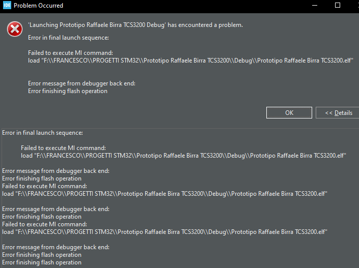

I tried and I can program with a file .bin or .elf, but if I try to program the MCU with STM32CubeIDE it shows me this error below:
So this is a problem if I want to debug or run the program..
Was STM32 Cube Programmer able to program the .ELF with some more specific error message?

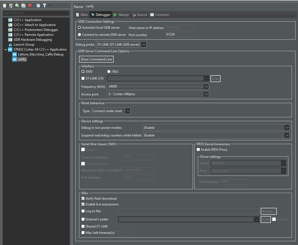

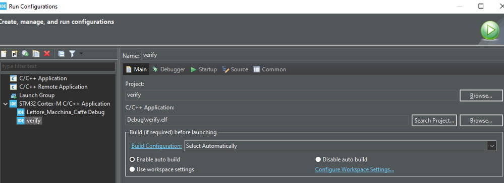

it looks like you are running/debugging it as a C/C++ application...From menu select run/debug configurations, STM32 application and double-click in configurations list to make STM32 run/debug configuration (not C/C++ application, which is for running EXE on your computer).

@Georgy Moshkin​ those are my configurations:
This is still from the IDE, and via GDB Server, etc.

What could I change in the GDB settings, and also wondering where should I go to see these settings.

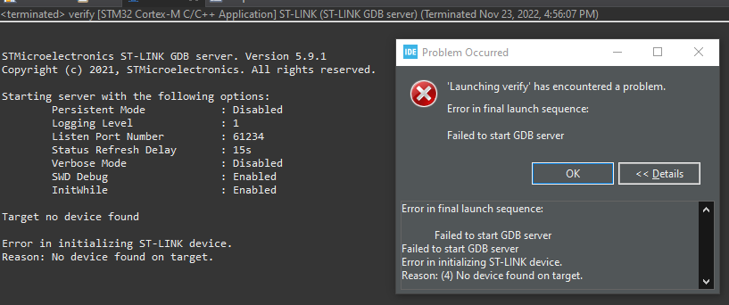

and this one:
