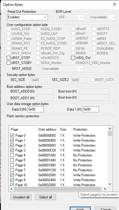

I have a small problem: I bought some STM32G0P0.. for my project, also making the PCB and the rest. But after soldering the various components, I try to program one and see that the level 2 protection is active, I try to program another and there is the same thing.

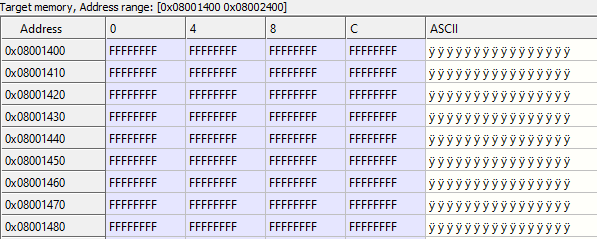

What I see from the STM32 St-LINK program is that only some memory pages have protection, while others don't, but then going to view the memory areas I see that they have all been set to FFFFFFFF.
Below I can see that the memory on the address 0x08001400 is free, but..
..here I see that is protected! How can I program it?

This is my Option Byte page:
I can't uncheck the write protection
What would change if I installed the STM32 programmer?
ST-LINK Utility does not support your MCU, because the MCU is newer than that software tool!

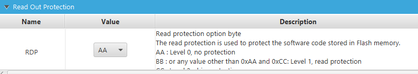

I used it but nothing has changed, in fact what I see is different but the memory is always protected.
The RDP settings:

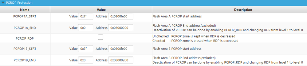

The PCROP settings:

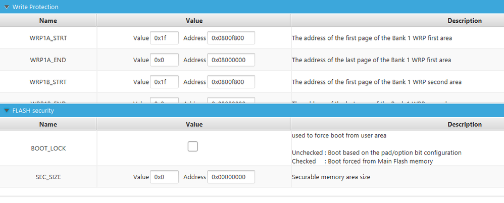

The Write and Flash settings:

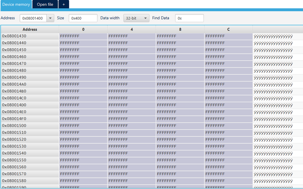

But the memory is always like this:
Do you have any idea?
Idea about what? That memory range is erased. What do you not understand?
