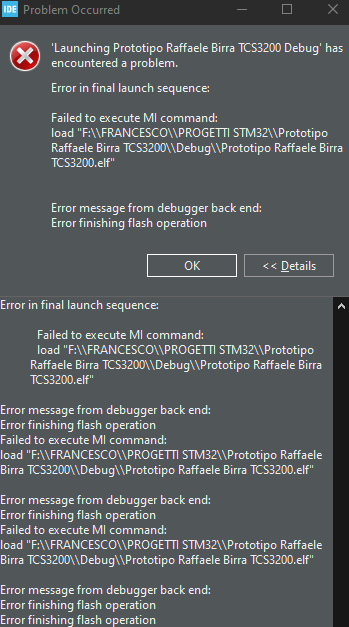

Now I'll answer @Community member​ . Right now I was trying to create a new project with a new debug configuration, but nothing to do, it gives me other errors that I can't solve:

@Community member​ I looked for the path with the two \\, which you pointed out to me and you asked me to verify that the path really existed, and indeed the path with the two \\ does not exist, but it could not be that STM32CubeIDE displays or uses the paths with double \\?
If someone were to tell me that it uses paths normally like Windows does, then there is a problem with the path, and therefore the question arises: how do I get rid of the extra slash \?

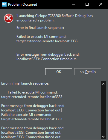

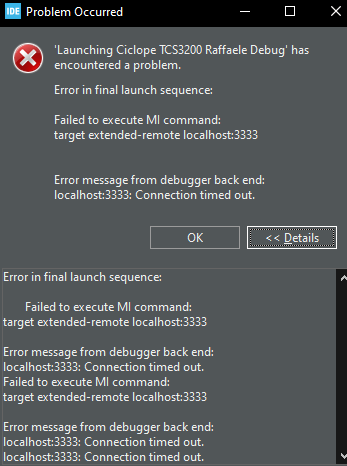

3) The error messages with two different configurations are these:
With Debug Probe set to ST_LINK (OpenOCD)

With the Debug Probe set to ST-LINK (ST-LINK GDB server)
STMicroelectronics ST-LINK GDB server. Version 7.0.0
Copyright (c) 2022, STMicroelectronics. All rights reserved.
Starting server with the following options:
        Persistent Mode            : Disabled
        Logging Level              : 1
        Listen Port Number         : 61234
        Status Refresh Delay       : 15s
        Verbose Mode               : Disabled
        SWD Debug                  : Enabled
Waiting for debugger connection...
Debugger connected
Debugger connected
                       STM32CubeProgrammer v2.11.0
Log output file:   C:\Users\offic\AppData\Local\Temp\STM32CubeProgrammer_a04348.log
ST-LINK SN  : 56FF6F067878545228250567
ST-LINK FW  : V2J40S7
Board       : --
Voltage     : 3.21V
Error: No STM32 target found!
Encountered Error when opening C:\ST\STM32CubeIDE_1.10.1\STM32CubeIDE\plugins\com.st.stm32cube.ide.mcu.externaltools.cubeprogrammer.win32_2.0.301.202207041506\tools\bin\STM32_Programmer_CLI.exe
Error in STM32CubeProgrammer
Shutting down...
Exit.

so on 1 : found no stm cpu to connect. on 2: found, but break to...1fffxxx
seem: the bootloader or watchdog is active .

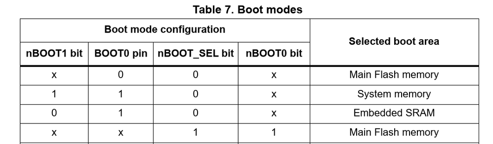

boot0 is lo ?
get connection with STM32CubeProgrammer to cpu ?
My STM32Programmer can see the MCU.
I haven't any Watchdog active in this moment.
The pin boot0 is the same of SYS_SWCLK. I don't know if it is high or low

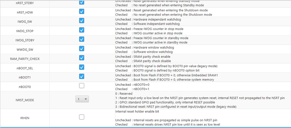

ah, ok, i see...what is the user option byte ? nboot-sel + nboot0 ?
Is a STM32G050F6P6
STM32G050Fx TSSOP20 pinout and click here to see the Datasheet.
The user option byte:
