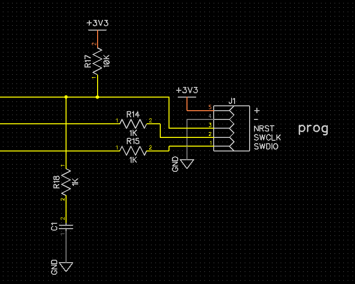

Hi @mattias norlander​ if it can be useful, here is the wiring diagram of how I did the programming part of the MCU:
Since I changed those two 1k resistors of SWDIO and SWDCLK (R14 - R15) I get the error from the previous post.
Did I miss something in the wiring diagram?
Thanks again for everything and happy holidays to all
R17 should be removed and C1 should be a 100 nF or similar, not 1 uF and such huge values, which are put there to compensate the unnecessary pull-up. Also C1 should be connected directly to NRST and R18, if necessary, should be connected in series between C1 and J1.
Edited by moderation team to adhere to community guidelines
Hi @Piranha​ . Ok.. so by removing R17 I wouldn't have the PCB 3.3V connected to the NRST pin right? Or should I, instead of R17, put a wire to ensure that there is always 3.3V?
Anyway, thanks for the advice, I'll try everything as soon as possible.
Merry Christmas to everyone!
Just remove the R17.
DS13514 Rev 2 "Figure 18. Recommended NRST pin protection"
RM0454 Rev 5 "Figure 7. Simplified diagram of the reset circuit"
AN5096 - Rev 3 "Figure 5. Simplified diagram of the reset circuit "
These pretty clearly show that the NRST pin has an internal pull-up to VDD. ;)

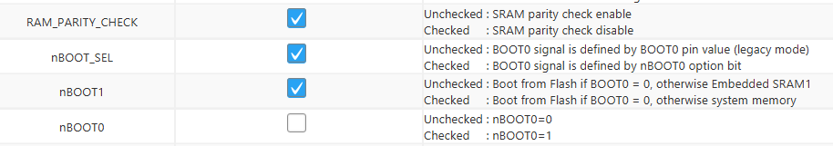

you still start booloader...
please show actual option bytes: (this was your setting)
0693W00000Y6uIxQAJ.pngnBoot0 is checked now ??
@AScha.3​ thanks, thanks and thanks again.
I flagged the nBOOT0 and it worked.
Thanks again!
