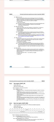

I suggest you to take a look at your bauderate configuration.
You can refer to this exemples.
On the RM0090 . Also, is better to use fast speed. For the data register, I advise you to create a function to transmit your data that is better to put it in a uint8_t variable and then append this variable to your data register. Finally, don't forget to make sure that you are connecting your TX to the external peripheral Rx and RX to TX. And if you are using a serial monitor, maker sure that all settings works fine. Finally, if the issue persist, you can try to debug your code.

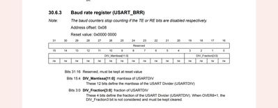

Maybe you should check the desired baud rate,
USART2->BRR = (7<<0) | (24<<4); // Baud rate of 115200, PCLK1 at 45MHz
2023-09-19 9:37 AM
At 16-OVER mode it might be easier to see if USART2->BBR = 45000000/115200 or (45000000/115200)-1 works better.
