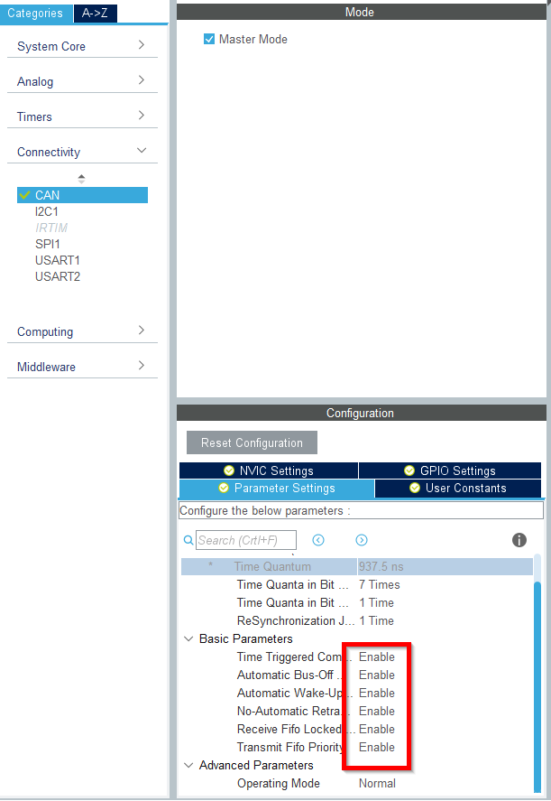

2019-05-17 1:32 AM
EDIT:
Seems to be an IDE problem: @ CAN CONFIG, IT SEEMS "ENABLE" in in reality "DISABLE" so inverted?!
Ok got it. Seems something with your introduction PDF is wrong:
After ENABLING the red marked CAN Config, the CAN BUS starts working as expected with your example:
