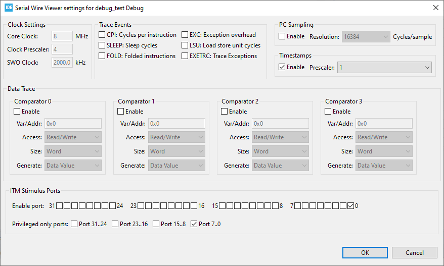

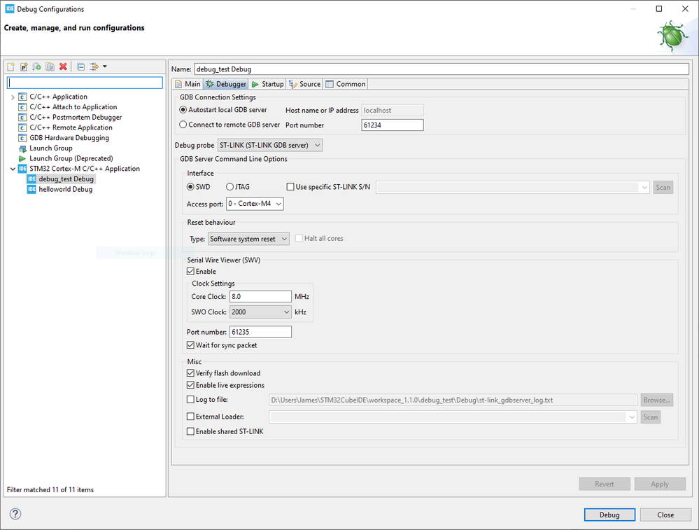

I am new to stm32 mcu and trying to debug with ITM here with CubeIDE. But it didn't seem to work for me.
I didn't see anything from the SWV ITM data console output windows, it's properly something really silly I have done or not done.
I am using CubeIDE v1.1, Nucleo-32 F303K8T6 board, so I think it's not the hardware problem.
So I created a new project, enable SWV, set the core clock to 8MHz (which is the default value I get when I setup the new project), enable port 0 on the SWV ITM console windows, start trace. I see nothing.
What have I done wrong, or not done??
Here is my code:

}Here are my settings:
