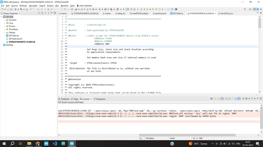

Hi team,
I am trying to implement FreeRTOS on nucleo32 board (stm32f303k8) on building the same with the one FreeRTOS task, I am getting a error that RAM overflowed by 66456 bytes.
It can be resolved or I need to go with some other high memory boards?

If you increase the size of the FLASH in the linker script, or related dialogs, the linker can get closure, with an unusable image, but you can inspect the .MAP file to see what's allocated to what/whom
10 REPLIES 10
Unless you can make your RAM utilization smaller you'll need a more capable part. Doesn't your current choice only have 12KB SRAM
What are you statically allocating that's going to put you 64KB over the available space?
Got some large 32-bit or float arrays? Too many tasks, too much stack space for each?

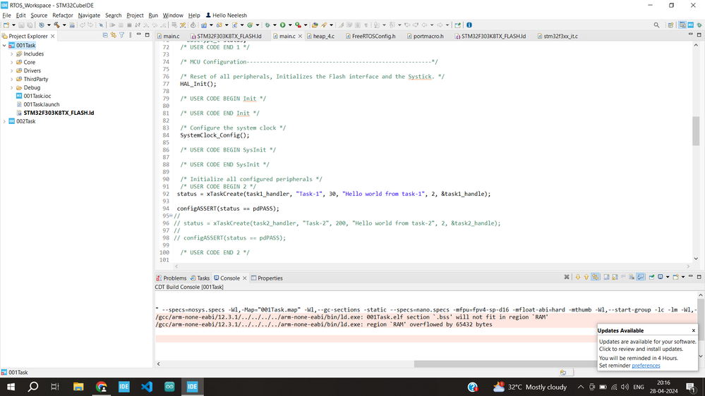

neelesh_vish
Associate II
I'm making just one task that too stack size of 30. I just want to print something as I am just a beginner with RTOS.
Still I don't know where it wants this much space.

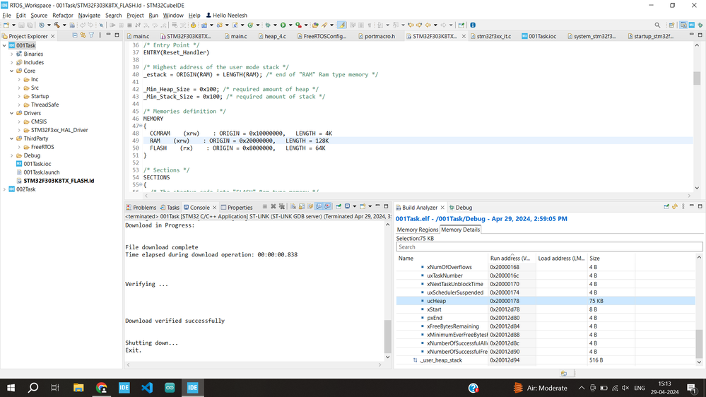

As you told to increase the size of FLASH in linker script,  I tried that, but the error was still there so I tried to increase the size of RAM (I know it's out of range) the error got resolved here, but I know it won't work for the future. While debugging the project it stuck in the HardFault_Handler.
As I inspected through built analyzer to check memory usage, I got that ucHeap is consuming around 75KB of memory. How can we reduce it?

In the linker script of the project the total heap size was defined as 75*1024 (#define configTOTAL_HEAP_SIZE ( ( size_t ) ( 75 * 1024 ) )that is because I have copied this FreeRTOSconfig.h linker script from other project. now I change it to (#define configTOTAL_HEAP_SIZE ( ( size_t ) ( 10 * 1024 ) ))  and it started working.
I will change the board for next, as I just want to print some lines that why I used it.
