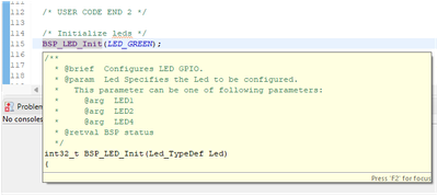

@Artur Laskowski do you see in CubeIDE unformatted function comment like below?
This is behavior of Eclipse. CubeIDE just inherits it from the Eclipse CDT code base. It can be improved, anyone is welcome to contribute.
The source seems to be in org.eclipse.cdt.internal.ui.text.hover.CDeclarationHover; getHoverInfo():
