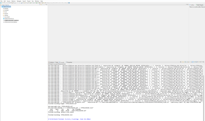

I just created a new project for the STM32L542CEU MCU with CubeMX and I'm facing two issues with the imported project in CubeIDE.
First issue, rather easy to fix, some path for includes files are missing in the project.
Second issue, two include files are missing:
Description Resource Path Location Type
fatal error: ARMCM0.h: No such file or directory RTE_Components.h /CURRENT_SENSING/Drivers/CMSIS/NN/NN_Lib_Tests/nn_test/RTE/_ARMCM0 line 17 C/C++ Problem
fatal error: irq_ctrl.h: No such file or directory os_tick_gtim.c /CURRENT_SENSING/Drivers/CMSIS/RTOS2/Source line 26 C/C++ Problem
make: *** [Drivers/CMSIS/RTOS2/Source/subdir.mk:25: Drivers/CMSIS/RTOS2/Source/os_systick.o] Error 1 CURRENT_SENSING C/C++ Problem
make: *** [Drivers/CMSIS/RTOS2/Source/subdir.mk:25: Drivers/CMSIS/RTOS2/Source/os_tick_gtim.o] Error 1 CURRENT_SENSING C/C++ Problem
make: *** [Drivers/CMSIS/RTOS2/Source/subdir.mk:25: Drivers/CMSIS/RTOS2/Source/os_tick_ptim.o] Error 1 CURRENT_SENSING C/C++ Problem
make: *** Waiting for unfinished jobs.... CURRENT_SENSING C/C++ Problem
