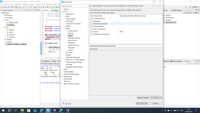

I made this function (see Figure 1) and made documenting comment. When I calling this function or I hover the cursor over the function name a tooltip with the function code pops up, but I want to see description of the function (@brief parameter from documenting comment, see Figure 1).

Hello @Mykola_Levun,
I think it should be here: windows> preferences

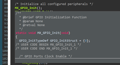

It is not work (see Figure 2).
Figure 2
When I check the box next to Documentation, then I get an error "'Documentation' hover uses the same modifier as 'Combined Hover' hover" (see Figure 2). When I uncheck the box next to Combined Hover, then there is no error, but when I calling function or I hover the cursor over the function name, there is no a tooltip.
2024-08-30 3:06 AM
Yes, obviously there is a conflict, since both combined hover and documentation have key modifier blank.. you should set a key modifier for one of them

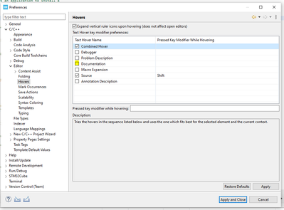

I did it (see Figure 3), but tooltips from the documentation comment are not shown; hovering over the function name only shows the function code.

2024-08-30 3:41 AM
It will show the comments before the function definition (not declaration), plus the function code, automatically. This is what "Combined Hover" does. Probably you don't have comments before the definition, only the declaration. Don't think you can change this behavior.
2024-08-30 3:58 AM
Hello @TDK,
Everything works as you explained. Thank you for explanation.
