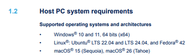

macOS 26.2 was released in December 2025 after the release of the STM32CubeIDE 2.0.0. Therefore, STM32CubeIDE 2.0.0 is supported only on the earlier macOS 26 Tahoe version, as stated in RN114.
The issue will be fixed in a future release.
