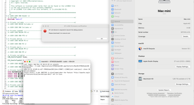

I updated to Mac15 (MacOS Sonoma Public Beta), which was probably a mistake. Now I get an error from STMCubeIDE when I try to run indicating "ST-Link Server is required to launch the debug session" and to Please download it on www.st.com.
I figured something changed in the OS that no longer makes the ST-Link Server run any more.
However when I try to download it, I get essentially a broken link, or at least it simply wont download. Even worse, the web page with Safari seems entirely broken and I cant even get a download to start after accepting the license, but with FireFox I get further, I get but still wont download and the link seems broke.
I can still flash using the STM32CubeProgrammer fortunately (using 2.13.1).
Can anyone tell me how to download this ST-Link Server? Or if there is an issue with the last MacOS and this and there is no fix?

| 191542 | STM32CubeIDE debugger no longer works in macOS 15.0 Sequoia (STLink and STLinkGDBServer support) |
Can anybody confirm as it still does not work for me.
I even have deinstalled the software, deleted remaining files and reinstalled ver 17.
