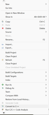

When I migrated by project to ST Cube IDE v2 this morning, my CM4 project would not link. I had to right-click the project and "convert to C++" (even though I had been using C++ for months with previous versions).

Resolution
Right-click the CM4 project and select "Convert to C++". (In v.19 the only available option was "Convert to C")
Clean and build.
Maybe this is a bug in the project migration process? Could it be specific to dual-core, where only the CM was configured for C++?

CubeMX wouldn't let me compile C++ when my project was like this; I had to compile C with Cubeide and it still gave me an error.
2025-11-28 7:31 AM
Hello @yogui_ricardo
After generating your code using MX , did you right click on your project then convert it to C++ and then build it ?
