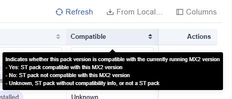

Regarding the Second point: It was decided to display all packs available on the server and only indicate their compatibility with STM32CubeMX2:
Note: Any displayed pack can still be installed, even if it is not compatible.
