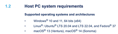

Per the release notes, MacOS 15 isn't officially supported yet. No doubt it will be eventually, but you'll probably have to wait.
2024-08-04 2:51 PM
Yep that makes perfect sense. I think I did get a bit aggressive on the update. Thanks for responding to that. At least I can still compile and flash with the command line programmer so I’m not blocked.
