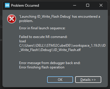

I am flashing a code to write into the last sector of the flash memory of STM32F401 Nucleo Board, for the first time the code was successfully dumped into the flash but while dumping it the second time this error pops up, whenever i mass erase the whole flash it again works properly but the second it doesn't. I even tried using different sectors but the issue was still there.
What might be a possible solution of this error.
I am attaching the snapshot of the error and the code snippet as well.

Hello @Vibhanshu5396
You should select "Connect under reset" in Debugger options. Is it the case? If not, try it please.
