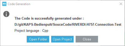

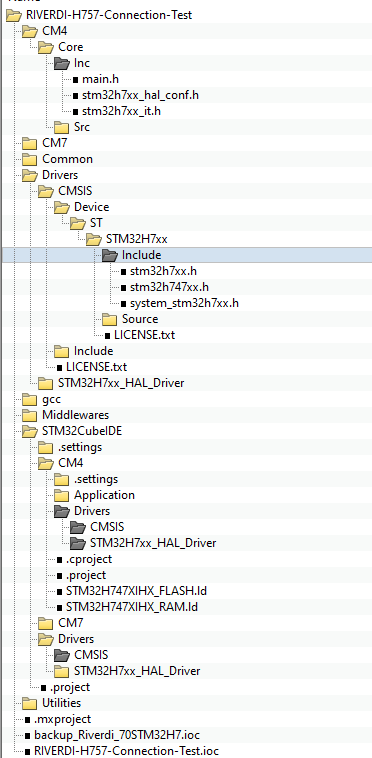

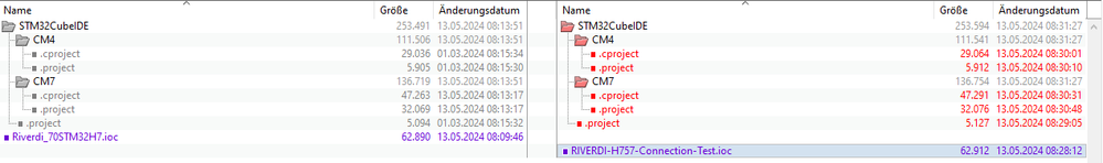

My goal is to use the RIVERDI example provided in Touch GFX and import it into the CubeIDE to add some peripherial features as ADC and CANFD. When the .ioc file is imported into CubeIDE all the generated folders are empty and even the .ioc file is missing despite the fact that all folders are present in the file system.

Update
The files are getting generated when using CubeMX only not on CubeIDE import, but the Project does not offer a "Build Project" or "Clean Project" option neither when clicking o the higher project nor on the CM4 or CM7 project. So i am unable to build ...

use the CubeMX Code Generation dialog >> Open Project

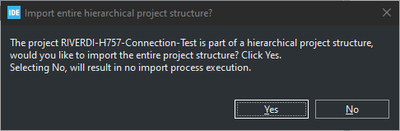

Import dialog >> Yes
several Project extists dialog >> Yes and several Delete Resources >> OK
and see al the files in the CubeIDE
