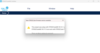

It's even worse if I switch away when MX is loading and it offers a firmware upgrade:
The popup is modal, so I can't resize to make the content visible. Need to cancel the load and start again to recover.
