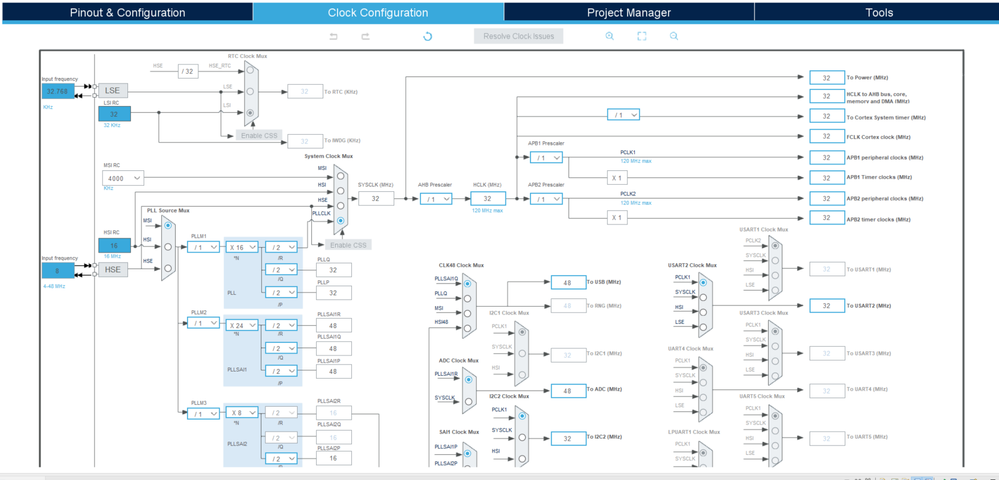

#endif /* USE_FULL_ASSERT */PUTTY serial output from ST
2024-08-21 7:45 AM
@Odd_coder wrote:My understanding is that i get signals from the ports i have specified as my I2C_SDA and I2C_SCL.
Not if you're looking for UART signals!
2024-08-21 7:49 AM - edited 2024-08-21 7:50 AM
@Odd_coder wrote:Same baud rate in the ioc and the Putty app. But still getting the same output.
So that suggests that your input clock is wrong.
Try routing the system clock to MCO, and measuring that on an oscilloscope or frequency counter.
Perhaps show your clock config.

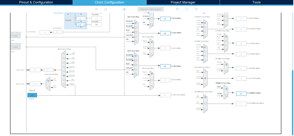

2024-08-22 5:17 AM
Am using default clock configuration.
2024-08-22 5:41 AM
Looks like you're using MSI?
Is that sufficiently accurate for async serial comms?
What if you use HSE instead?
