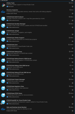

I am working on a fresh VSCode profile where only the following extensions are installed:

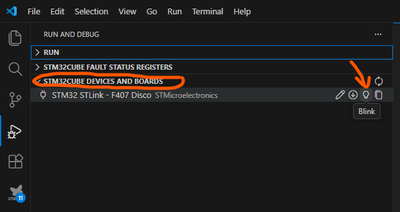

2025-12-22 2:40 AM
2025-12-22 2:58 AM
Yeah that was working fine. I opened up cube programmer and tried to connect there that wouldn't connect either. I was getting DEV_TARGET_HELD_UNDER_RESET error. I don't know why this happens but my project works on a UART connected mesh and my development boards (my pcb) are connected to each other during development and debugging. I disconnected them from each other, connected to them one by one and performed full chip erase and now they work fine. I face similar quirks from time to time and after full chip erase it goes back to normal for a good while. Could it be that my firmware is preventing the debugger to connect? Do you know a solution for this? Should I add a delay before my program starts if I am in Debug configuration to let the debugger connect?
