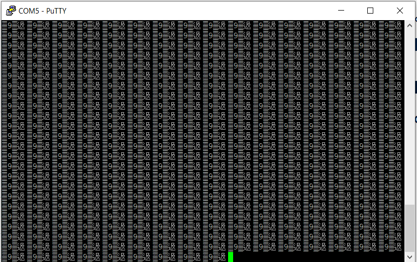

I just got a NUCLEO-L4R5ZI-P and trying to test it out before i start my project. I tried the simple "Hello!" on serial and displaying via PuTTY cmd on windows. It is printing gibberish or maybe am missing something. Am new to ST and any help will be appreciated. I have tried a number of solutions but same result. Here is the main.c code and the output on PuTTY cmd.

#endif /* USE_FULL_ASSERT */PUTTY serial output from ST
2024-08-12 3:34 PM
The commonest reason for getting gibberish on a terminal is wrong baud rate:
Check your clocking.
Use an oscilloscope or logic analyser on the wire to see what the actual speed is.

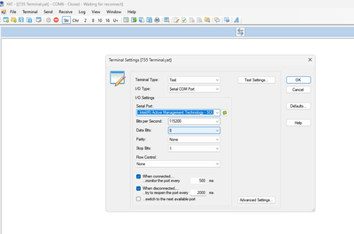

Try using the software called YAT terminal, this have easy interface,
Check whether the setting son both microcontroller and the terminal application are the same
like Baud rate, Word length, Parity, Stop bits these should be same on both.

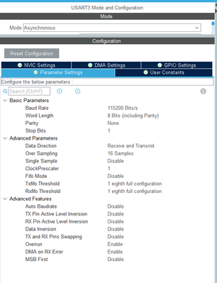

2024-08-21 3:08 AM - edited 2024-08-21 3:10 AM
you can check it in the ioc settings of the uart
above is the settings that i used in the YAT software on PC
this settings location may vary with different software
you must have the same settings on the receiving software / uc as of the ioc settings

This is what I have been doing. Same baud rate in the ioc and the Putty app. But still getting the same output. So yes, checking the actual baudrate is what is required

@vishnu_illikkal wrote:you can check it in the ioc settings of the uart.
But that assumes all the other settings - in particular, the clock settings - are correct.
If the System Clock is not at the expected frequency, then everything which depends on it - including UART baud rate - will be wrong as a result.
