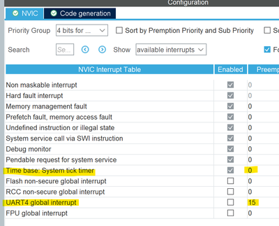

HAL_Delay needs SysTicks to keep firing to work.
Make your SysTick interrupt higher priority (numerically lower) than your UART interrupt priority. Like this:
It's generally frowned upon to have blocking code, or code that takes a long time to complete, within an interrupt handler, but that is a separate issue.

2024-08-21 7:23 PM
Now it works!!
Really really thank you.
