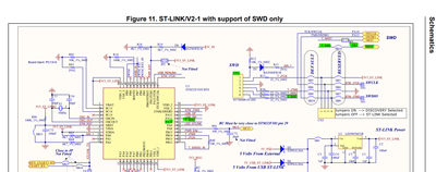

My problem is supposed to be a very simple one. I use an interrupt to send messages to my PC, then I send a message back to my STM32. The message is received in good order but I can't print it out. I watched every single YouTube video out there, implemented every single solution (including connecting the SWO to the PB3 pin) - nothing works so far.
Can anyone tell me where am I mistaken?

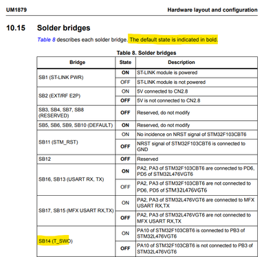

Hello @nick_iliev ;
According the UM1879, to connect T_SWO pin in CN4 to PB3(SWO) pin you need to solder SB14.
Thank you.

Hello @nick_iliev and welcome to the community;
Are you able the see the message when using a terminal such as TeraTerm?
Could you please check the status of SB14 solder bridge.
Thank you.
Kaouthar
2025-12-11 11:02 PM
Hello Kaouthar,
I use DockLight and I do get confirmation for a received message. I can also see the message in my Rx buffer during debugging via the variable explorer.
Thanks for the reply! Yes, the bridge seems to be unsoldered. Perhaps I have to solder it?
Best wishes,
Nick

Hello @nick_iliev ;
Thank you.
Kaouthar
2025-12-15 11:43 PM
Hello Kaouthar,
Yes, this appeared to be the problem. Thank you!
