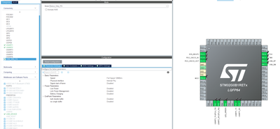

I would like to enable the USB HID Device function to the target uC of the NUCLEO board. So I've created a new project, selected the board and added the 2 USB pin configuration:

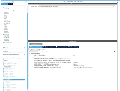

I've also enabled the middleware functions:

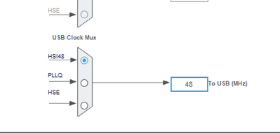

the clock config seems to be correct:

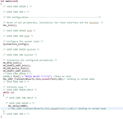

and the generated code is (I've just added a hello world string on serial):

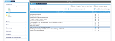

solved.... just enable interrupt in the .ioc file:
