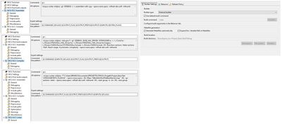

I've just compiled the default NUCLEO-G0B1 project example, and I think there's already a .lst and a .map file:
And here's my settings (they could be all default values):
Is there something missing?

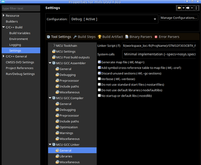

By the way, my options are
and I think the .map file is already generated with the linker options. Do you think there's something wrong?

map file -> look at project -> properties :

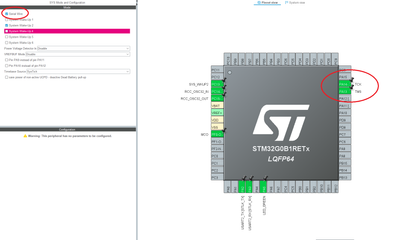

Try: make : menu -> file -> new -> stm32 project .... select cpu, give name (wait...until it shows ioc edit) ;
set in ioc : debug to swd ; then generate code ;

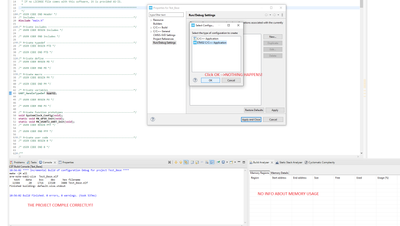

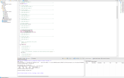

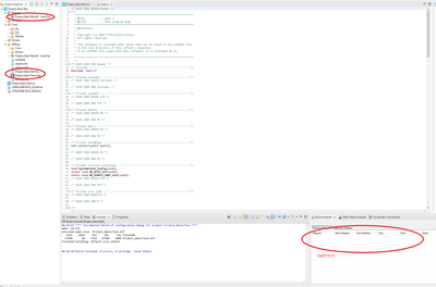

2024-01-19 1:25 AM
Hi @AScha.3 ,
yes, I've done the required steps: generate code and build, obtaining no errors and no warnings, but the .lst and .map files are generated (the mem usage is still empty):
2024-01-19 1:49 AM
Ok ok, and the -> debug ? ( You have set debug -> configurations -> (this test_proj ) first )
