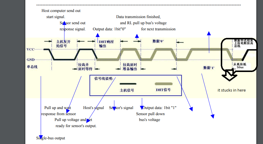

I'm trying to use DHT22(temperature and humidity sensor). I'm using STM32F030F4 Here is it's datasheet DHT22 Datasheet
In first few seconds. I can get values. But after a while it stucks in here:
So i try to implement a timeout to prevent this. I start another timer (TIM14). And after 2 seconds i try pull the pin to low manually.
But as a result, variable 'k' (which is in the HAL_TIM_PeriodElapsedCallback function) never increments. So, again code stucks in same line. Could you help me, how can i implement a timeout to pull the pin low after a while
Here is the link of datasheet:https://www.sparkfun.com/datasheets/Sensors/Temperature/DHT22.pdf

You'd need some secondary test so it actually leaves the loop at some point, Perhaps via an iteration count, or inspecting the TIM CNT to determine a maximum for elapsed time. ie 20 or 40 ms, whatever is reasonable for the sensor.
Also be aware that callbacks are operating in interrupt context, if they block they will prevent other interrupts from firing.

Perhaps you should handle the case where the device doesn't respond? Like having a timeout and retrying rather than loop infinitely. If you sense this case you could set a GPIO to trigger an analyser to inspect the situation in more detail.
Your ms delay is same as us delay, might want to pause longer between probes.

thanks. i fixed my delay. I tried to implement a timeout. But still it stcuks on line 67. Can you take a look again, please?
2019-10-18 6:25 AM
2019-10-18 6:56 AM
thank you. i added these two lines and now it works:
uint32_t ilk = TIM3->CNT;
while ((HAL_GPIO_ReadPin (GPIOA, GPIO_PIN_2 && (( TIM3->CNT - ilk) < 8000) )));uint32_t ilk = TIM3->CNT;
