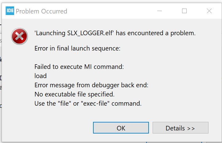

I now get one error on the load

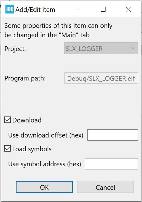

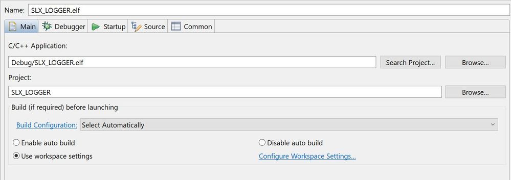

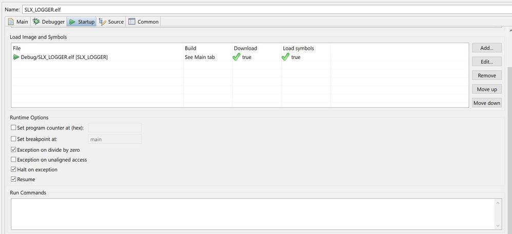

My debug configuration is as follows
The file SLX_LOGGER.elf is present in the DEBUG sub folder but for some reason it cannot load this file. This project works in TrueStudio.

I have moved on a stage.
The path and .elf file name are not being passed for some reason, even though they are setup in the debug config tabs above.
if I add the following debug init command, the file is loaded into the target and the target is reset...
-file-exec-and-symbols Debug/ SLX_LOGGER.elf
...however the launch only reaches 93% and the RESUME button is grayed out.
To fix this I needed to uncheck RESUME in RUNTIME OPTIONS in the debug config.
