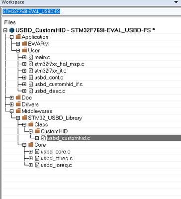

By following the steps mentioned above , I 'm sharing the generated project with you
I compared the generated files from my project to the generated files of the example CustomHID_Standalone for STM32F769I-EVAL to see what files could be missing
==> same generated files .
I will be waiting for your feedback.
THX
Ghofrane

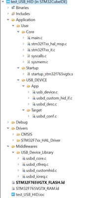

Thank you for your Prompt response.
PFA, I have enclosed images showing the generated files for your reference.
Looking forward to your support.
Best regards,
Badrinathan J
2025-02-12 4:29 AM - edited 2025-02-12 4:47 AM
Hello @Badrinathan
Try to use STM32CubeMX 6.13.0 standalone , it works correctly
A child ticket has been raised to STM32CubeIDE team in order to fix the issue (Internal ticket number 202905 )
THX
Ghofrane
