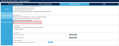

2025-08-22 1:29 AM
Hello @Bucky1
I suggest you try the "Delete previously generated files when not re-generated":
But as a recommendation, it will be better if you refer to the configuration of your original .ioc file and start a new one to ensure that nothing will be generated will not configured.
Best Regards.
