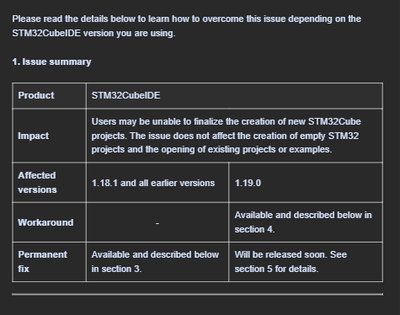

Recently, I received an email from ST recommending an update to the latest STM32CubeIDE v1.19.0 (screenshot attached). I updated my IDE as suggested.

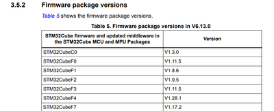

Hello @Manogna_V
STM32CubeIDE 1.17.0 ( integrates CubeMX 6.13.0) means you used to work with the firmware version STM32Cube_FW_F7_V1.17.2 as specified in the release notes
First, check if this firmware is already present on your PC under C:\Users\<YourUsername>\STM32Cube\Repository. If it’s missing, download it from this LINK
extract the .zip file, and place the extracted folder (named exactly STM32Cube_FW_F7_V1.17.2) in the repository directory.
After that, open your project in STM32CubeIDE 1.19.0, open your .ioc file, and navigate to the Project Manager. Uncheck the option "Use latest available version," then select STM32Cube_FW_F7_V1.17.2 as the firmware version and generate your code.
Please try this workaround and let me know the results, so we can address any further issues if they arise.
