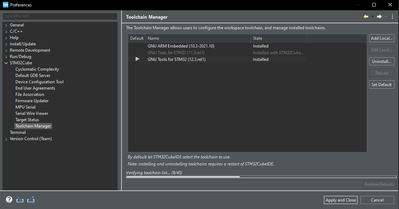

Hello @Nico1
The GCC 12.3 is know available to be installed in CubeIDE. You go to Window > Preferences > STM32CubeIDE > Toolchain manager. You can install it from there.

But for my use case I would like to avoid having to dig up the toolchain from the installation folder of STM32CubeIDE. So a proper release of STM32CubeCLT would be much appreciated, since we want to use it on our build server and currently I don't even quite know how to download the Linux version of the toolchain from an Eclipse software center without setting up a Linux VM and downloading it there.
How can I download this new version? Or how long until the next STM32CubeCLT release?

The quickest way to update the toolchain version for the STM32CubeIDECLT, copy the folder of the toolchain from the STM32CubeIDE installation repo "\plugins\com.st.stm32cube.ide.mcu.externaltools.gnu-tools-for-stm32.12.3.rel1.win32_1.0.0.202310241603\tools" in the "GNU-tools-for-STM32" folder under the CubeIDECLT installation repo.
You can use this solution and I will reach for the dev team to get a systematic way to make the installation.
