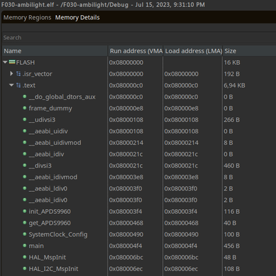

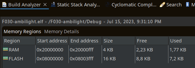

Example : on a F030, 16KB flash, i made an "ambilight" for my TV, driving some (7m long) RGB light strips and reading the (average) picture color with an RGB-sensor over I2C.
Program is 7,2KB (-Os) and fits easily ; HAL here needs about 5,5KB , doing everything from RCC clock tree init to I2C functions. My "program" is just 1,5KB or so. (No floating point of course - that would be no good idea here.)
So if you want to know, what needs space, just look in:
-> details ->
