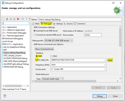

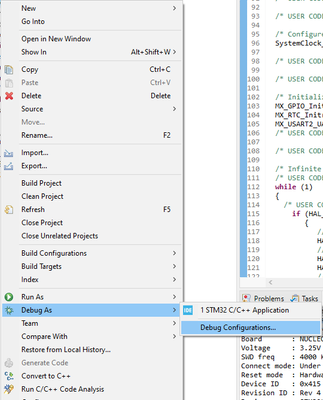

Could you please click on "Debug Configuration"-> "Debugger" tab, and click on ST-LINK S/N and scan as shown in the below figures.
Could you please try with another cable?
