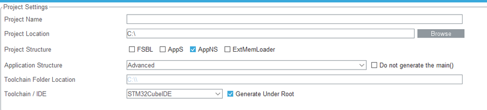

In the Project Manager, you can select AppNS to generate only the non-secure version of the project, which is most likely what you are looking for.

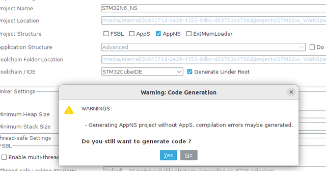

I've tried suggested. To generate only non-secure project. CubeMX prompted the warning, and after the generation the code does not build.

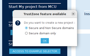

 Also, in the CubeMX new project wizard, there is no option to generate only non-secure or trust zone disabled project. Is this currently not supported or ? Screenshot from 2026-01-01 13-14-09.png

I stand corrected; please excuse the misinformation in my previous message. Due to the architecture of N6, both secure and non-secure projects need to be generated for successful compilation. Regarding using the MCU more traditionally like Cortex-M3 to M7 (except M33, M35P, and M55), the only way is to enable and configure peripherals in the Non-Secure domain (AppNS). After generating the project, you should edit only the non-secure project. That’s all.

Due to its architecture, it's not possible to disable TrustZone on STM32N6.
After reset, the device always starts the BootROM execution in secure mode, then jump in a FSBL application which is still in secure mode.
From CubeMX you have the possibility to generate projects as below:
- FSBL + Application Secure
- FSBL +  Application Secure + Application Non Secure (integrate firmware isolation)
If you do not need this security model, you should use other STM32 device without TrustZone feature.
