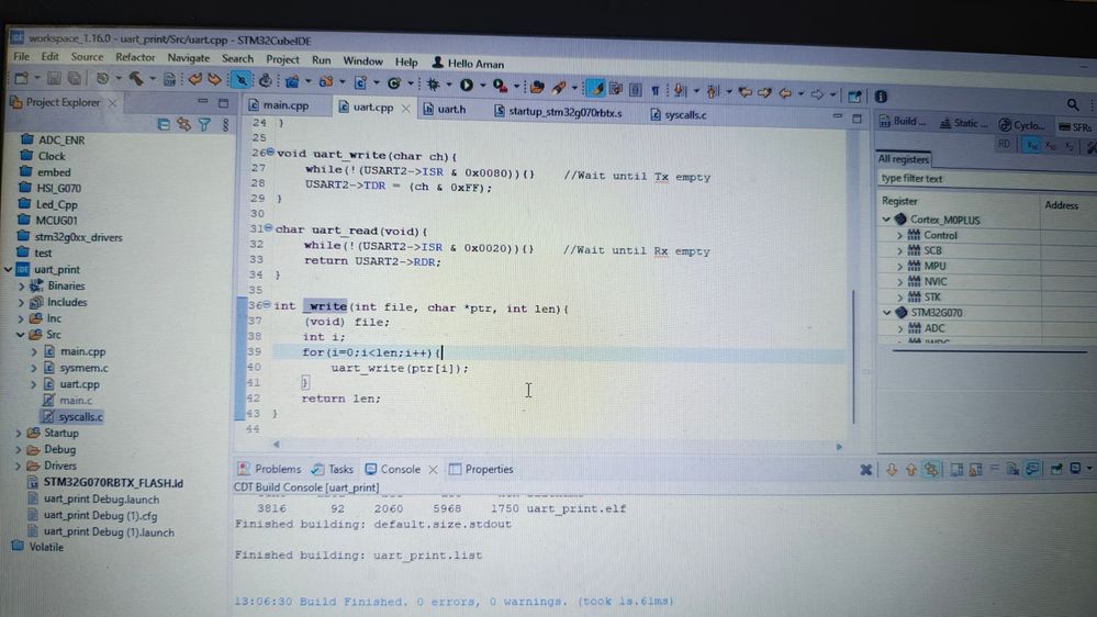

I'm trying retarget printf. My uart_write function is working correctly and i'm able to see character on Teraterm.
But when i try to use printf it is not working. i even tried semihosting to execute printf but it fails. i'm attaching the screenshots -

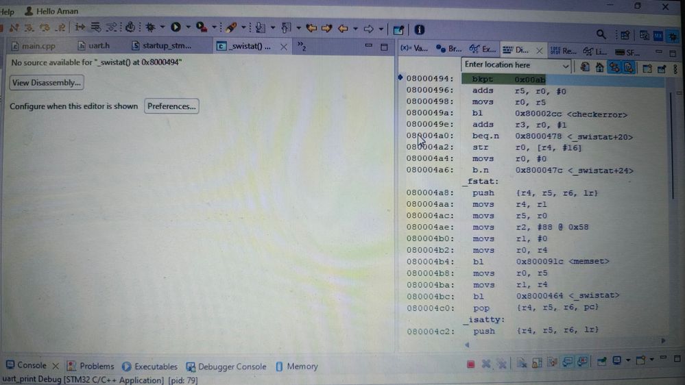

Disassembly of the code stucks at "bkpt 0x00ab" -
any solution for this problem?

Hi @KDJEM.1 ,
I appreciate your comment. But the link provides the way to retarget HAL library UART, which i see is working fine.
But here I'm using CMSIS library to write my UART driver. And here it is not working.
2024-09-17 2:05 AM - edited 2024-09-17 2:06 AM
@Andrew Neil sorry for that. I'm not using a personal computer rather a corporate one were we have limited access to file sharing.!
2024-09-17 2:06 AM
@AVerm.4 wrote:i even tried semihosting
Presumably, the screenshots you shared show your semihosting attempt - as this works via the BKPT instruction?
https://interrupt.memfault.com/blog/arm-semihosting
Instead, follow the Knowledge Base article linked by @KDJEM.1
And here's a 3rd-party article on the same: https://shawnhymel.com/1873/
2024-09-17 2:10 AM
@AVerm.4 wrote:the link provides the way to retarget HAL library UART, which i see is working fine.
It really shouldn't make any difference - they all just end up writing to the UART.
If you're hitting a BKPT instruction, that suggests you're configured for semihosting - you don't want that.
2024-09-17 3:16 AM
I tried both of the above solutions but there is no success in using printf.!
2024-09-17 3:21 AM
Again, if you're hitting a BKPT instruction, that suggests you're still configured for semihosting - you need to get rid of that.
2024-09-17 3:27 AM
Sorry missed to mention i have disabled semihosting. Even reconfigured a new project still stuck with not working "printf" whereas "uart_write" function working correctly.
