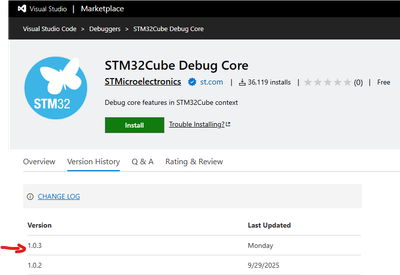

2025-11-24 10:36 PM
@Burrr @Andrew Neil @ArnaudC @Cartu38 OpenDev
Please be aware that the issue has been fixed and the extension update is now available.
