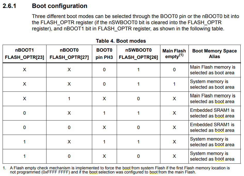

Issue:
My issue is that when attempting to debug the MCU in STM32CubeIDE, it often attempts to start at address 0x1fff51F4 with the message "Break at address "0x1fff51f4" with no debug information available, or outside program code". main() is never called because my breakpoint at the top of main() is never hit. To mitigate the issue, I simply press the red "Terminate" button to stop the debug session, then press the "Debug" button to restart, and the program then loads at the correct address and breaks in main(). This happens randomly without any changes to the code, option bytes, or hardware. Yesterday it was happening about 50% of the time, now it's about 10% of the time and seems to change in frequency. I wouldn't mind stopping and restarting the debugger to mitigate, but CubeIDE take roughly 3 minutes to program and connect the debugger so stopping and restarting is time consuming.
Question 1: What could be causing this strange behavior of STM32CubeIDE jumping to address 0x1fff51f4?
Question 2: Does STM32CubeIDE not load the PC (Program Counter) with the application start address and jump to that? Or does it still look at the option bytes / BOOT0 pin to determine start address?

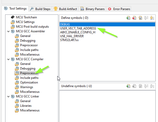

I have a solution for my situation:
I experienced, that the flash content is every other time is not mapped to 0x00000000 despite the fact, that the memory relocation register indicates, that flash should be mapped to 0x00000000. Every other time at 0x0000 0000 there is bootloader code. The Vector Table register VTOR still sets the Vector Table to 0x0000 0000. If an IRQ occurs, it would jump to bootloader instead of my program.
By setting VTOR to 0x0800 0000, the program runs fine with IRQs.
CubeIDE project settings has an option to set the VTOR register each time, the code starts.
void SystemInit(void)
#if defined(USER_VECT_TAB_ADDRESS)
/* Configure the Vector Table location -------------------------------------*/
SCB->VTOR = VECT_TAB_BASE_ADDRESS | VECT_TAB_OFFSET;
#endif
/* FPU settings ------------------------------------------------------------*/
#if (__FPU_PRESENT == 1) && (__FPU_USED == 1)
SCB->CPACR |= ((3UL << 20U)|(3UL << 22U)); /* set CP10 and CP11 Full Access */
#endifBut for this to happen, you need to set a global define USER_VECT_TAB_ADDRESS
This fixes the problem for me. The flash content is still not mapped to 0x0000 0000 each time, but the software starts each debug session properly.

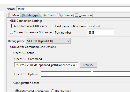

2021-07-08 12:04 AM
Further observations:
When opening older projects with STM32L4, now I encounter the same problems not starting a debug session other time. We never had this problems in the past. So why do older projects now starting to get problems?
I assume, that the STLINK driver / debugger module in cubeIDE has changed an now shows problems.
I can avoid this problem by switching to open OCD mode.
With open OCD mode, the debugger always starts properly on my STM32L4R7 project. (custom board)
